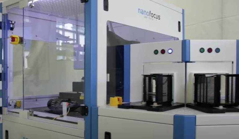

Similar system form NanoFocus: NanoFocus µsprint: Fully automated wafer inspection

Due to the non-disclosure agreement with ASE, we are not allowed to take a video of the workstation for demonstration. However, A similar system from Nano-focus can be referred as the following:
https://www.youtube.com/watch?v=Xvg0_MkTz7w
