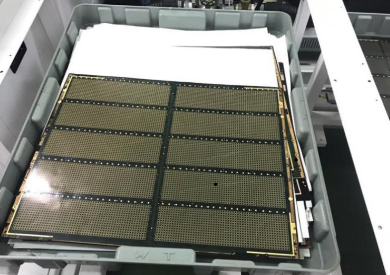

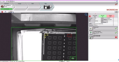

3. Since those PCB are put into the tray randomly without any alignment as Fig. A-1, Fig. A-2, so the biggest challenge is how to detect the orientation and the displacement of PCB, and then Robot can offset the error and put it into the Laser Marking machine exactly. Besides that, there are more than hundred types of PCB designed for different clients over the world. And TCI request us the automatic system should be capable to deal with all kinds of PCB without asking operator to change program menus.
圖檔
Fig. A-1

Fig. A-2
